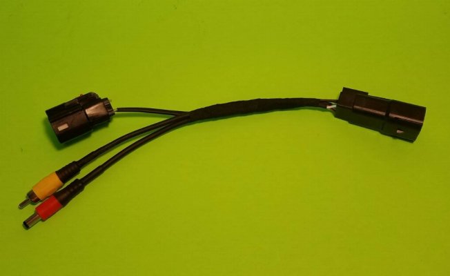

Alright folks, 2 new items we are offering for those that have asked (Limited availability due to parts on hand):
- NEW 11/1/17! Factory Backup Cam Connector Breakout: $60 Shipped
Allows bypass of factory tailgate/camera and use of an aftermarket camera. Retains factory lock/unlock if tailgate is still installed. Handy if you have a camera at the end of an RV/Trailer or if you use an aftermarket spare tire carrier w/Camera that blocks the factory unit. Aftermarket cameras do not support the active/turning gridlines like the OEM camera (they would be fixed).
