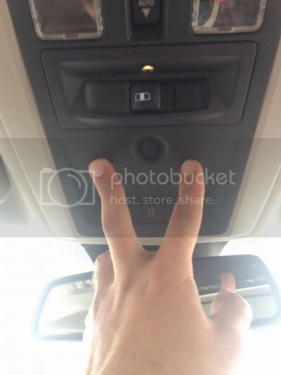

first things first, we need to pull down the center console. you'll find four connectors holding it to the roof as dictated in the pictures here:
there are 2 located about here on both sides
and the other 2 are located here:

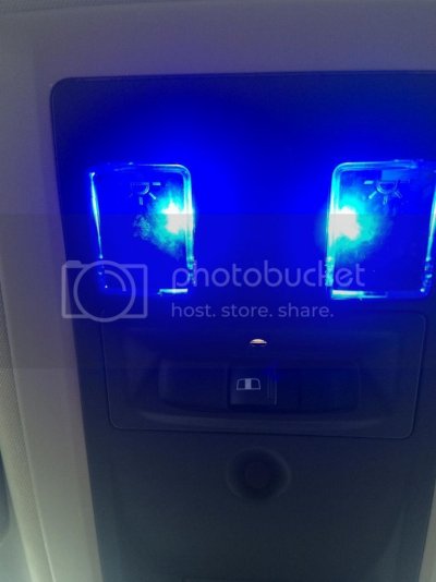

Here's a picture from the outside with the blue LEDs.
Remember I did reinstall those chrome plates, however I think it might be brighter without them on. I'll need to confirm that

Very cool! Why the blue lights, though? I'm just curious. Can you see ok when you need to?
Cloviz
Cloviz
Feb 3, 2014
214
35
My truck is all brown and silver; exterior and interior. The blue lights give it a nice color pop imo. As for visibility blue lights Produce a higher wavelength on the spectrum. So I don't have and issues seeing other then everything blue baba dedadda die

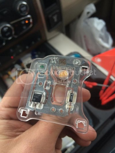

EDIT: upon further inspection of the chip with the led in the rear dome light I discovered it's a dual layer chip(sneaky ********). The prongs for the LED is soldered on the lower layer then oats all sandwiched together....I can't remove that led so I glued some clear blue plastic over the led and it's blue, but it's hard to say how it looks in the daylight

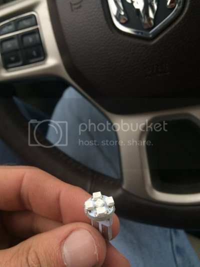

What size leds are those? I got some T10 laying around ib the house

Sorry to bump an old thread, but I'm new to my Ram 3500 Laramie and have this issue of "Flickering" on the drivers side. I love your writeup and feel this will be very easy to follow. I have one question. What Bulb is the correct bulb to buy?
**Edit... found the answer on another forum. https://www.cumminsforum.com/threads/2014-limited-map-light-led-replaceable.1826593/
it's a 194 LED, Ordered off of Amazon earlier this week, and confirmed by installing last night and I have good LEDs again!! **
