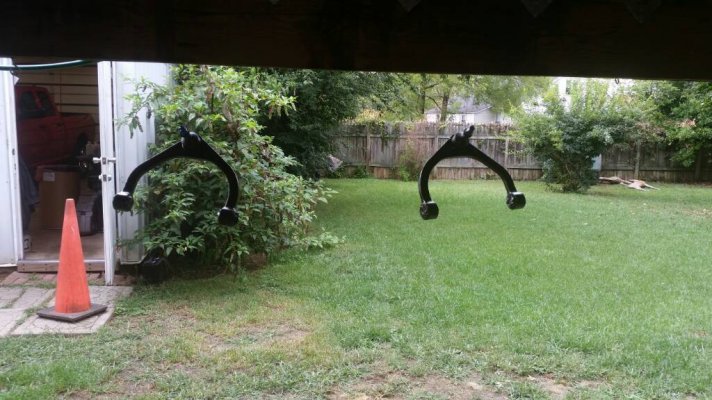

Painted the MEVOTECS with VHT Roll bar & chassis paint from Advance Auto.

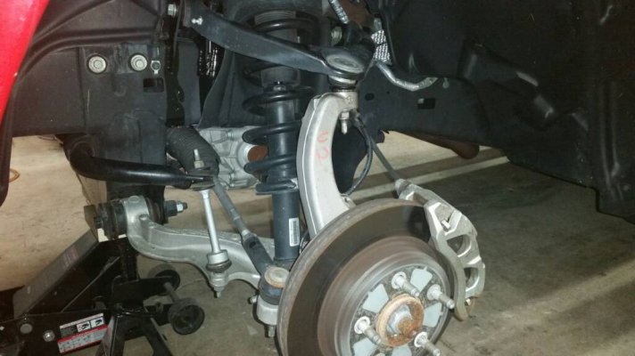

OEM Installed UCA'S and strut.
Everything removed .

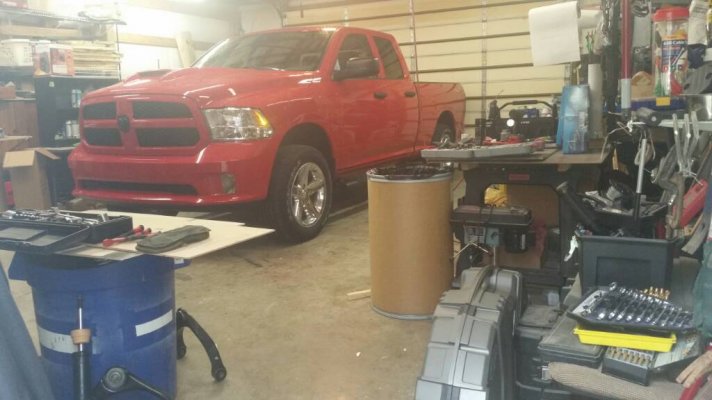

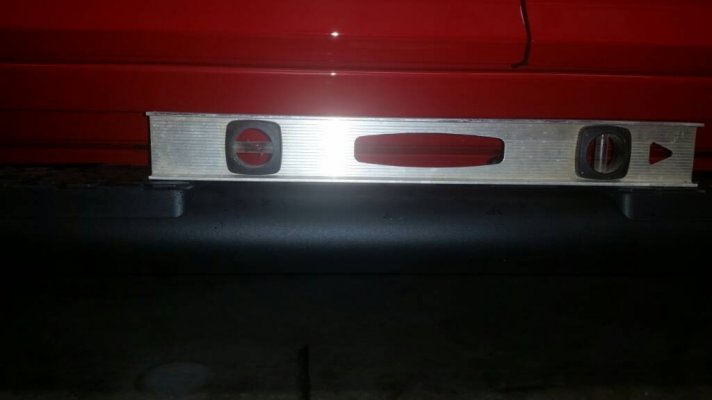

Bilstein shock set to + 2.8" and Mevotech UCA installed .
Almost a perfect level for me ! +.250" in the rear .
Picture above is a before picture.
Below is an after .
Below is an after .

I have to ask, how did you take the first picture, it's tripping me out. :crazy:
The UCA'S are hanging from my deck .by wire , I'm standing under my deck . Lol i.never thought about it till you said something .
It kinda looks like they are suspended in mid air...

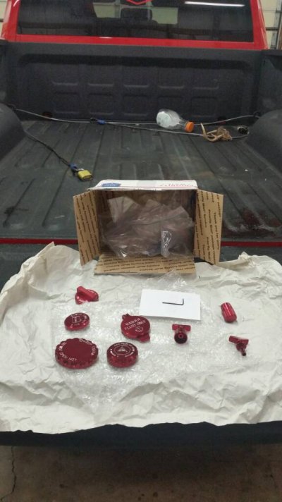

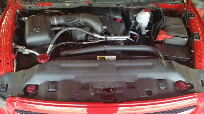

Look what I'm installing right now !
It's the RED Billet under the hood dress up kit I got off " Pull Ya " a member here .
Merry Christmas to my truck !
