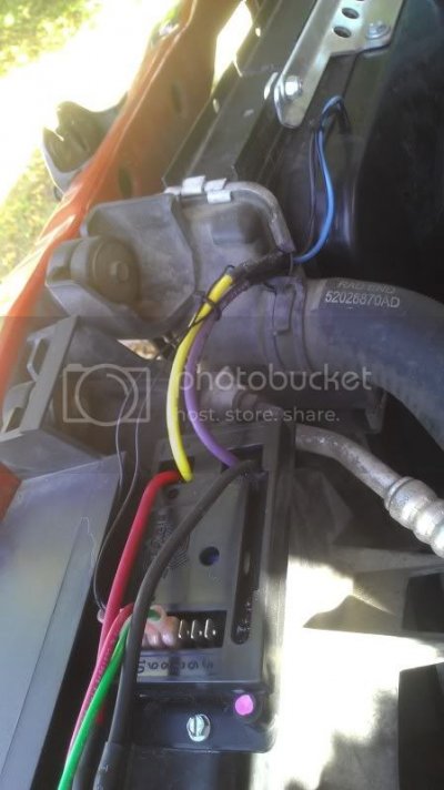

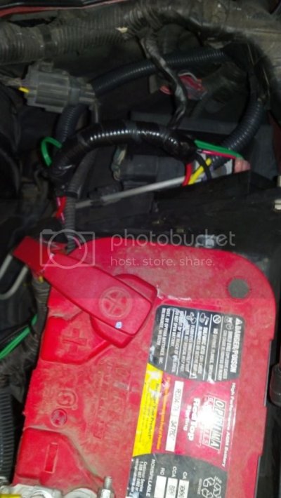

redram2007
Sep 29, 2012
1,092
60
Colorado Springs (Ft Carson)
4.7
Mounted mine here behind the battery box.
296543[/ATTACH]"]2012-10-06_14-48-14_809_zpsc334bc62.jpg
296545[/ATTACH]"]2012-10-08_12-44-10_342_zps91707400.jpg
