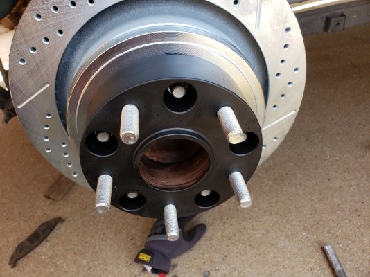

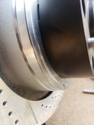

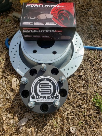

I have the supreme 1.5" hubcentric spacers on my 2015 Ram 1500. I absolutely enjoy these and installation was effortless. No cutting studs or anything.
Clean the surfaces, torque to wheel installation specs in random order, add blue locktight. Recheck torque after about 150 miles.
I've had mine for almost 2 years... Zero issues.
