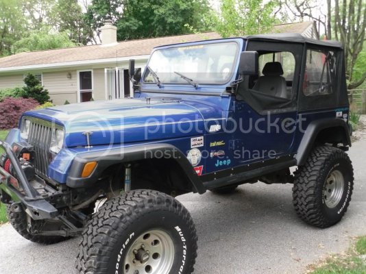

Any welding on the 1.5 BL for Ram
Yeh I figured it would be a three man team
Took about that for the jeep which is a 1" BL had to drop the radiator and cut a bigger shifter hole as well as weld on supports on a 4" plus and spring over axle
What a blast that was
