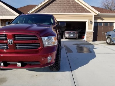

-12mm but 35x12.50s these are 18x9s but if you buy 17x9s you would have the same offset/stance.

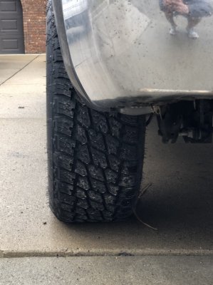

A 0 will keep you flush with the factor fender flare with a stock tire size, maybe stick out justtt a hair . This is the only pic I have now but it’s a +0 with a 275/60r20 with a 20x9 wheel IMG_1313.JPG
