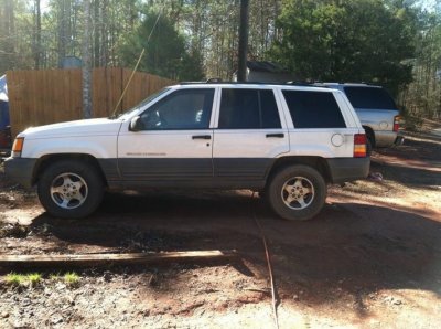

Good thing I bought this
At least it runs
