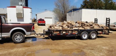

20190423_133528.jpg 20190423_133547.jpg 20190423_133541.jpg 2500 Laramie 2014. Wondering if the trailer is overloaded at 17,800 lbs total, truck and trailer. I just got it weighed. I think my truck weighs what, 7000 lbs?

Is that wood green? I've towed my 16' car hauler 2 axle loaded just as full like that. No problemo, 4.7 4wd Dakota, f150 5.4 and my 6.4. my C load tire say 1820lbs Xs 4 =7280lbs.What is that green Oak?

It is mostly green elm.

You should be good. That trailer should be good for 10k. It would have a GVW sticker on it.

Yep you probably have 10k+ pounds with just the trailer and wood (including the weight of the trailer).

If you were worried why didn't you just weigh the trailer? Sounds like weight wise you're fine, but big tex has a lot of tandem 7k trailers so maybe not. There will be a stamp on it somewhere with its rating. I'd be more concerned about spreading firewood along the road.
