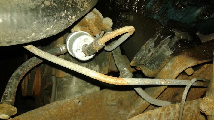

As for the proximity of the fuel line to the exhaust manifold, here is a picture of what I mean:
5KNMvUU
. Here is a link in case my IMG formatting is off: http://imgur.com/5KNMvUU
Is that too close? I've noticed a large air bubble in that clear filter in the picture, so I'm thinking it's too close and I'm dealing with some vapor lock. I'd like to reroute the fuel line and keep it off of the wheel well, but I can't find any pictures or diagrams depicting where I should run the fuel line. Any ideas? Where does your fuel line enter the engine compartment?

that should be fine. i ran my fuel line under the motor mount in the frame and then to the fuel pump instead of up like you have.
also if air is getting into the system i would almost be wondering if the fuel pump might be going bad because that is a bit of a strange spot for an air pocket to develop if things are working properly
