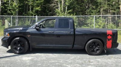

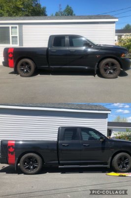

Here’s some pics

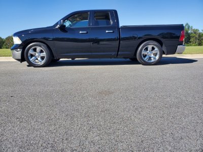

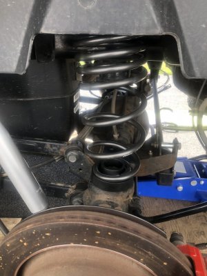

I posted this on another post last week, but looking at your measurements, you probably have 1 coil cut off in the rear.
So I measured around the coil and cut 7 1/2 inches measuring around the outside of the coul up front and 1 coil rear, plan on cutting 1 more off this weekend in the rear. I measured ground to wheel well opening with tape measure centered in the center cap.
STOCK.
LF-36 1/4
RF-36 5/8
LR-38 5/8
RR-38 7/8
CUT COILS
LF-32 3/4
RF-33
LR-34 1/4
RR- 34 1/2
HEIGHT DIFFERENCE
LF-3 1/2
RF-3 5/8
LR- 4 3/8
RR-4 3/8
If I hadn't dropped to a 275/55- 20 tire, the height will be a half inch taller as that tire size is 1 inch shorter over all. With stock tires, the difference with what I'm running would be.
LF-3
RF-3 1/8
LR- 3 7/8
RR- 3 7/8
Height should be
LF 33 1/4
RF- 33 1/2
LR- 34 3/4
RR- 35
Would like to know what you measure at if you can post it.
I also had about 1/2 a tank of gas as well. Hope that helps.
I cut another coil on the rear over the weekend, gonna get measurements when I get about the same amount of gas and the coils settle back in.
