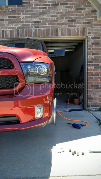

This is a 17x9 with 0 offset. If you get a 17x10 it will poke out about another half inch.
