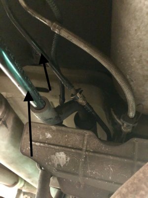

This is looking from front of tank. I added arrows to tubes that were melted on the exhaust manifold clamp.

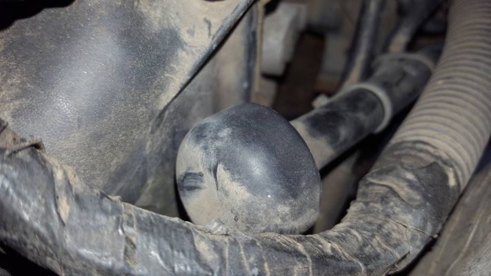

Well it looks a little different than mine but for me, the larger hose is actually capped off right behind the cylinder head. The smaller one goes to the purge solenoid.
