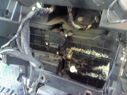

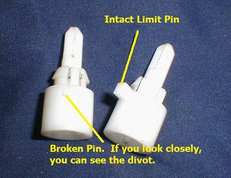

3rd & 4th Gen HVAC systems are almost identical
Even the Doors PIVOT Points are made of the same crappy white plastic that snaps off
The Actuator has an arm on it, the arm fits into the white pivot point, the other end of that piece is attached to the Door
3rd Gen HVAC
