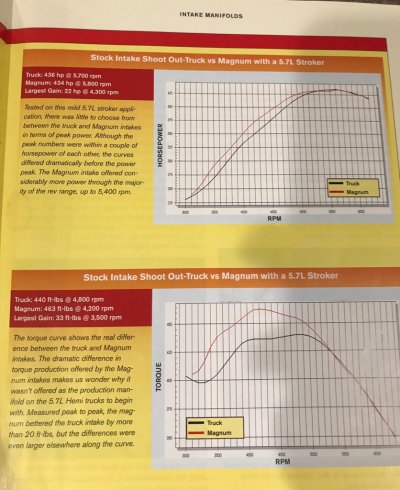

I’ll tag you in a dyno graph comparing the two intakes later. It was a direct comparison on the same slightly built motor. The car intake had a huge improvement under the peak curve, I suspect that it has longer runners then the truck does. Could be why it’s rated a few peak hp lower then the truck

This is how I got that info. It’s a mildly built motor, basically a 6.1 stroker, comp 260 and ported early heads. But the comparison is only between the two intake. Maybe the difference on a bone stock motor would be smaller, maybe not

Difference on a bone stock motor would probably be about........5hp and 15tq lol. Regardless on any kind of performance upgrade the earlier intake manifolds are the choke points. Forced induction can overcome quite a bit but still benefits from something that breathes better. Though to be fair, there is a mid 12sec 392 stroker 05 quad cab running around using the stock intake manifold on top of 3rd gen big valve heads lol. The occasional shot of nitrous puts him at about 12 flat.
