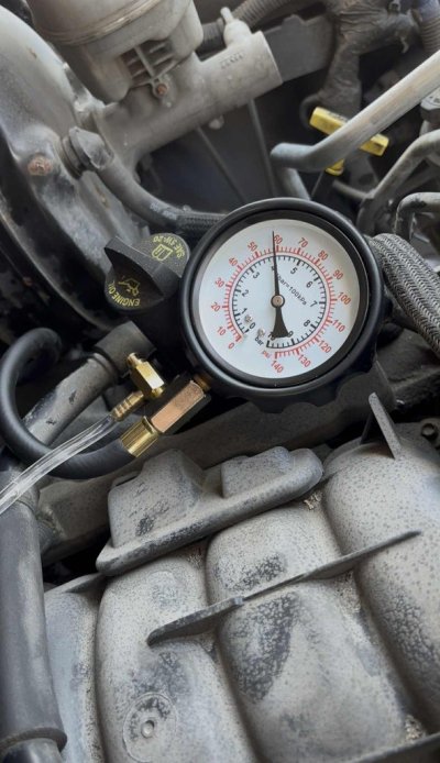

have a 2011 ram 5.7 hemi , everything was fine next day wont start just crank. Will start up with starter spray and dies. NO engine codes. I check the fuel pressure where is connected to the rail it was 58 psi which is good so the fuel pump good, try to tipm bypass but same. Took off the rail and the injectors not working at all checked the fuses all seems good. Thats how far i can go to diagnose. Any idea why all the injectors are not working at all? thanks

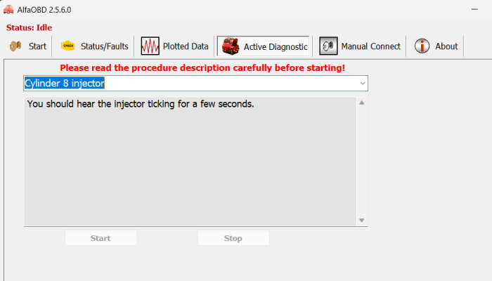

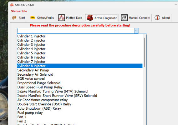

If the injectors have power, then the problem is probably on the PCM control side.
You'll need a bidirectional scan tool to go any further with diagnosing. If you don't have one, you'll probably need to take it to shop.
You can get an OBD Link MX+ and AlfaOBD, which has really good Bidirectional controls.
It will give you the ability to test fire the injectors, to verify that the PCM injector control transistors are still capable of grounding out the control side of the injector circuit.

AlfaOBD and the OBD Link MX+ are the go-to for Ram, Dodge and Jeep. It's the best bang for the buck. It also allows you to change BCM options, amongst other things. Alot of things that scan tools can't do.
But, Alfa only works with Android phones, or Windows computers. I don't think it works with a Chromebook or with Apple stuff.

yes the rpm moves while cranking, disconneted the fuel line before the rail 58-60 psi, took off the rail try to start to see the fuel but nothing at all
