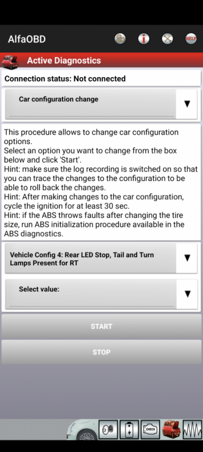

have a 2012 Ram 1500, I replaced the turn signal bulbs with LED bulbs and getting the fast flash and bulb out light on my dash. I have the ALFAOBD to try to switch it to having LED bulbs but when I go to the 2012 body module it doesn't show anywhere I can switch them to LED. I've tried newer year models I see the configuration change for LED but it won't let me change it over to it. What am I missing or doing wrong or can I not do it to a 2012. Anyone with a 2012 Ram been able to get it to work on theirs using ALFAOBD or am I going to have to use resistors. Any help will be appreciated.

I see this under MY 2012 .
Easy fix if it dosent work is a chep resistor.
