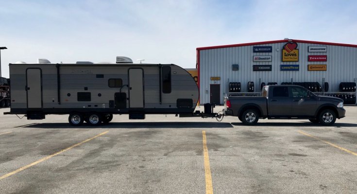

I have a 14’ 1500 5.7 8sp 3.21 gears and I’m pulling 7k. Just got back from the scales and dialed in the equalizer hitch. I want a 2500 down the road, but this truck performs just fine for our rig. 735cb98d615daae3033199374dae8a91.jpg
