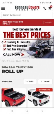

Hey all, I have a 2014 1500 Laramie crew cab that I'm trying to buy a roll up tonneau cover. I bought a TruXedo TruXport that said it fits the truck but when I installed it it is a good inch and a half too long so the back of the cover sticks out past the corners of the bed, the front is about a half inch from the cab. I then proceed to measure the bed and from the top inside of the front bulkhead to the top inside of the tailgate I find the bed is 65.5" so the bed is shorter than what everything said it's supposed to be. Hopefully you can see what I'm talking about in the pictures
Have any of you seen this on your truck?

You have a 5'7" bed.

I have a 2016 Big Horn and I have that same tonneau.It fits perfectly.Looks like you may have the wrong size
