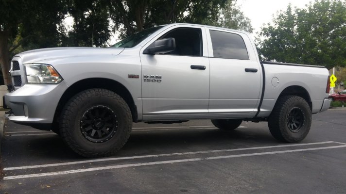

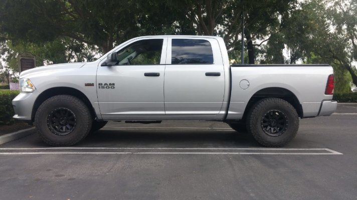

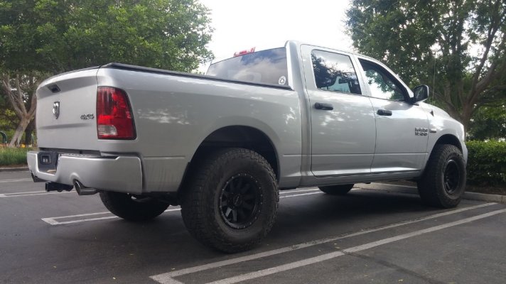

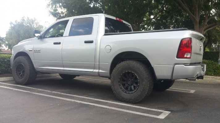

With the stock springs, the rear will be at 40 1/8"
With the Icons 1.5" springs, i'm now at 41 1/8"
I have a 100lbs full spare bolted inside the bed (before and after), Icon claims the springs are 25% softer than stock in their 1st stage, so i guess i'm hitting part of that 1st stage at the moment
I didn't install the liners back, as i'll be testing the new flex, and i want to watch the shocks to see how they compress and if i need to add bumpstops in the back
20181007_145354 by Wrangler RSM, on Flickr
20181007_145408 by Wrangler RSM, on Flickr
20181007_145427 by Wrangler RSM, on Flickr
20181007_145444 by Wrangler RSM, on Flickr
