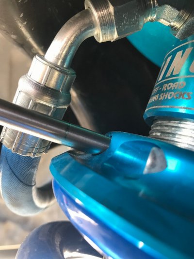

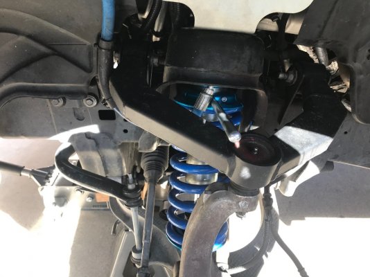

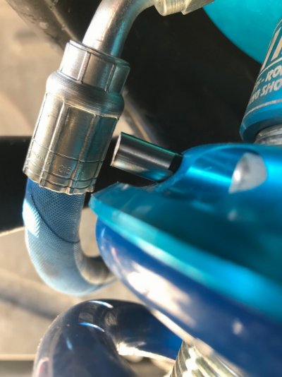

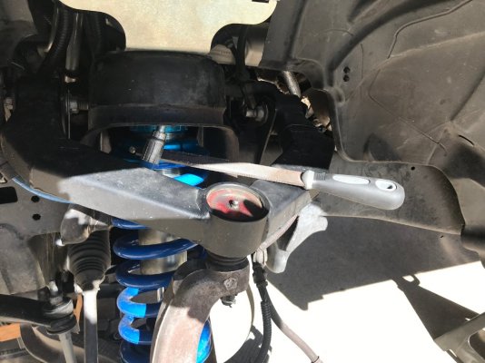

Decided to give my coilovers one turn as they've settled a little more and was running 39 1/4 to the ground from the 39 3/8 i had originally, not that i'm that picky, but mostly because i wanted to see how tough was the job of adjusting them while on the vehicle :), let me tell you is a little ******, doable though, but it's not a breeze.
Main issue is the reservoir hose being in the middle asides from the strut tower clearance.
There is no way to turn the fackers on with the tool provided or any other spanner wrench if i had one.
This is the tool provided by King, kind of like a long punch, can't turn past this point on the driver side because the hose is in the middle, and there are not visible holes where to place the tool.
45943947494_139b588c5a_h.jpgUntitled by RAM RSM, on Flickr
Here comes Harbor Freight to the rescue :)
They have a punch set i bought for $8 i think, picked the 5/16 punch and made a mark where i thought the piece i needed was going to clear the hose, and used my HF grinder to cut it, 1 min job total
46668824921_21bf48a877_h.jpgUntitled by RAM RSM, on Flickr
Then wrapped one end in electrical tape and inserted the tip in the hole..
45753645445_e996f6efcf_h.jpgUntitled by RAM RSM, on Flickr
and then just pounded away until any hole is available for the the King provided tool to fit :), passenger side is another mess on it's own, but the combination of the little 5/16 punch with the longer one does the job well.
31727060457_2d1fc033e1_h.jpgUntitled by RAM RSM, on Flickr
End result
both sides are now 4 full turns from the factory settings and essentially 9 visible threads on the driver side, 8 on the passenger side.

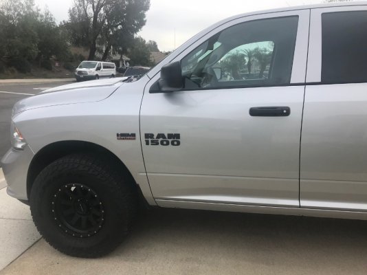

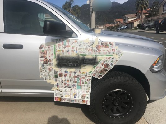

Dipped the RAM badges today
32856210658_641f905901_h.jpgUntitled by RAM RSM, on Flickr
46678546962_c2e5524a29_h.jpgUntitled by RAM RSM, on Flickr
31789899387_071b95c997_h.jpgUntitled by RAM RSM, on Flickr
46006651074_f12e0129ab_h.jpgUntitled by RAM RSM, on Flickr
46678544832_a5fa3d5c5b_h.jpgUntitled by RAM RSM, on Flickr
Didn't do the one in the front grill as i thought that one blended it better that way
45815717315_df2c5c1295_h.jpgUntitled by RAM RSM, on Flickr
46755708341_efa1f3d676_h.jpgUntitled by RAM RSM, on Flickr

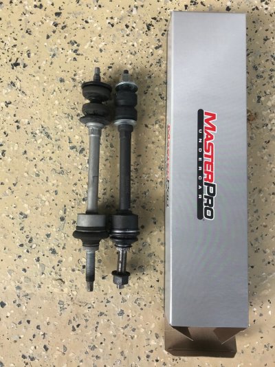

Did a refresh on my front sway bar links, the top bushings looked all cracked i guess from their age, maybe my fault as i think i cranked the top nut all the way the last time i had them off when i was installing the coilovers. in any case i bought the replacements from my local oreallys, Masterpro K80894, kept the stock ones just in case as spare.
39790288863_128e6181b9_h.jpgUntitled by RAM RSM, on Flickr
