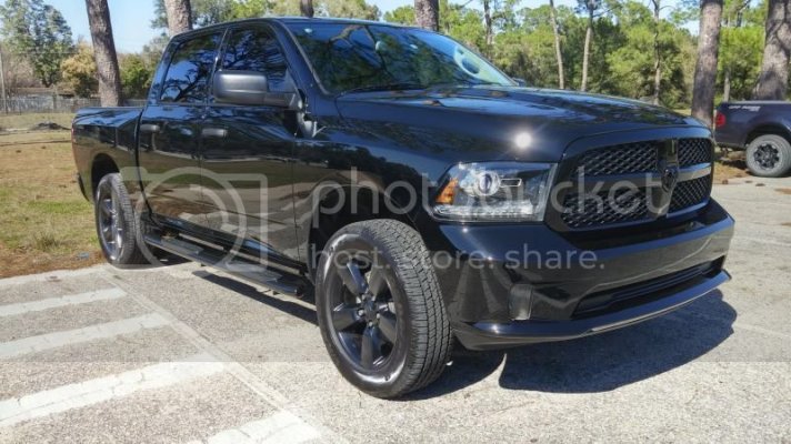

JCJ4290
Sep 23, 2012
418
67
2014 CC 4X4
1.75-2". I did a 2.5 and my front sits just a tad higher than the rear
But the truck had 400 lbs in the back in that pic
