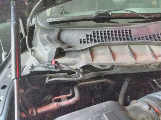

That foil may be a failing repair from a prior owner. I took a picture of the general area on my 2014 for reference.
