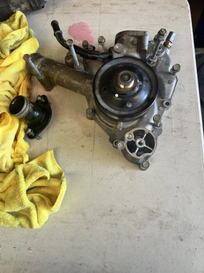

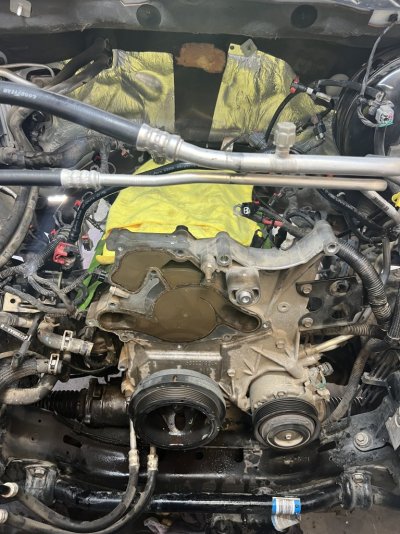

I just got the water pump off but I don’t have the inverted torq set to remove the AC compressor studs. I will have to wait on pulling the timing cover until I go to hobo freight to get the right tools. Might go here shortly.

A little update… I found out a number 5 12 point socket fits perfect on the 2 studs… removed them no issue. Now there’s a bolt in the back of the compressor holding it in place, I was going blind and thought I found the correct bolt… WHOOSH there goes $400 of 1234yf Freon!
Waiting for the fumes to settle before I go back out there and assess. I’m sure I just made the EPA very happy.

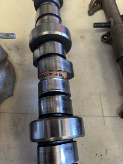

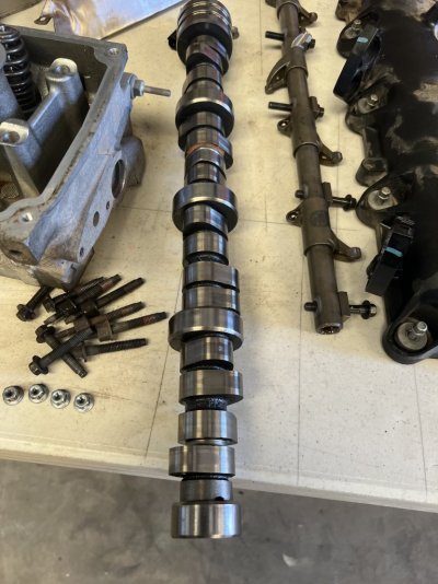

Cams out! One wiped lobe and a couple others with wear. Crankshaft balancer got so scared of the 1/2” air gun at 120 psi the bolt fell right out, 3 tooth jaw puller was a bit of a pain and luckily my father in law was here to give a hand. I ended up setting cylinder one to TDC and making a couple paint marks. Zipped tied the chain off to the side with tension as not to slip teeth on the crankshaft pully. All in all not to tough. Just have to have patience and good tools oh and a couple cocktails helps.
Rest of the parts come in next week so hopefully next weekend everything is buttoned up and I can take the wife and kids to the lake.
