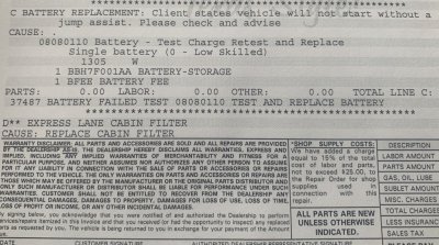

Dealership hooked me up. Replaced mine under warranty. Can’t beat that.
Nice. For future, I put an Everstart H7 AGM from Walmart. Not the biggest fan of the Everstarts but since I work there and get a discount, couldn't pass it up. The AGMs also have a 4 year full replacement warranty good at any Walmart with batteries. Just so happens my wife's Town & Country uses the same battery. Had to replace both this year. [emoji53]
