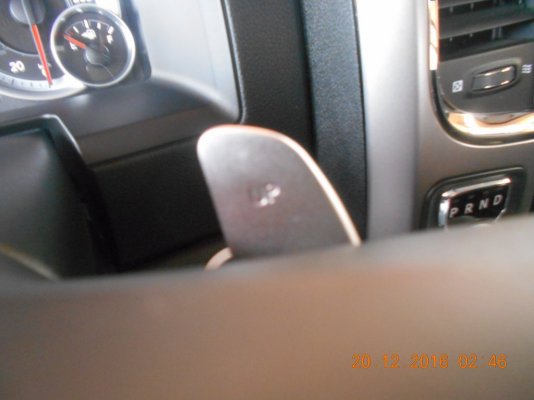

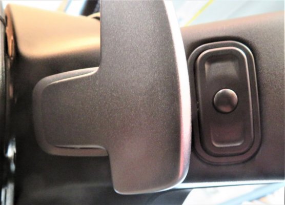

Hunt up Blackfox Brandon on facebook,he's building a kit to install them into an 8 speed 4th gen,but they work like the buttons,just faster and more precise.Other option is to get ahold of Russel at Sound German,as it's my understanding he has a kit to actually make the paddles work like they do in the cars,but i think it entails a TCM swap inside the transmission,and a specific transmission tune.I have paddles in my 14,and i've had paddles in the wifes last 2 Challengers,and i actually prefer the trucks paddle set-up,over the cars paddle set-up.

The trucks TCM doesn't support the same tiptronic set-up you can get in the cars. With a transmission tune and using something like what Brandon is building,actually works pretty good. Brandons paddle set-up is a take off,of what young Dylan was building. I've had Dylans paddle set-up in my truck since the fall of 15,and with my transmission tune,i prefer them over the cars set-up. With a good transmission tune and Brandons paddles,you can make the paddles in an 8 speed truck,work similiar to what the cars have though,it's not quite the same,but is close. The biggest advantage is the paddles are more precise then the buttons,you pull them once and it shifts,where-as with the buttons,you usually have to hit them a couple times to get the truck to do what you want.
