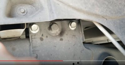

I watched a video on youtube where Gerbit shows he tows a pretty big 5th wheel toy hauler with his 3500 with Ram Boxes. He also shows the mounting points where the available factory 5th wheel prep kit brackets are attached. (The next picture was captured from his youtube video)
