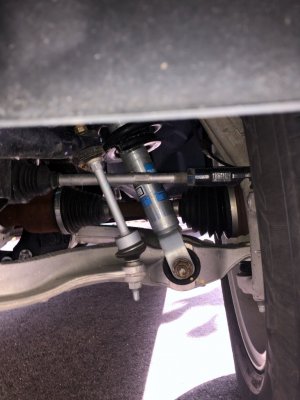

so i tokk the cv axle out and the non wheel side is wicked loose its not tight at all is that okay?
CV joints shouldn't be loose. I think you found your problem. There should be some play in & out a bit, but if it is loose like you are describing, that would cause the vibration at the upper speeds.
