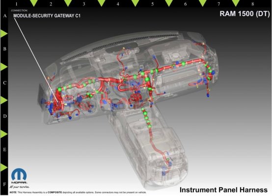

You both are referring to the can connector location not the actual security module. The module itself should be located behind the radio.

Found this diagram. That's for the DT (new body style). The classic (DS) is based on the 4th gens so as I stated it should be behind the radio
