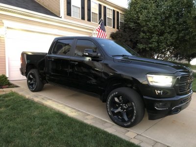

Do you have a side shot of your truck?

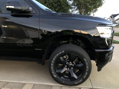

Not my favorite angle for pics of trucks, but since you asked, here you go. I'm also adding a slightly different angle below.View attachment 132522
Good lookin truck. I'm like you, I couldn't keep it stock. I went with the Readylift kit with control arms and 34s. Once more options come out I'll probably end up going with a true 4" lift but that will be after I do everything else to it.
