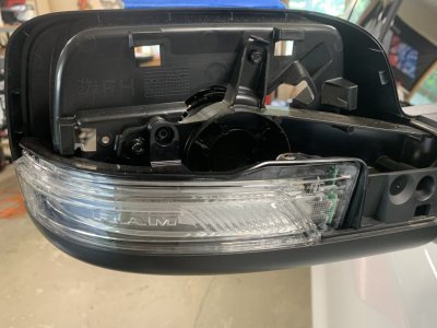

Figured this one out ages ago. Go to Harbor Freight and buy a mirror suction cup. Use this on the face of the mirrors to remove. Then remove screw(s) inside and Walla no mirror breakage. Good Luck......

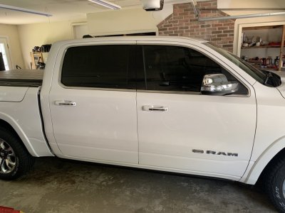

Thanks for all the advice, swap completed no broken parts!410B6A98-A85D-4A98-85C0-7827D63886CB.jpegB02636AE-7788-4B97-BF05-728B8F09395E.jpeg5C7DE3A4-2A31-48AD-A0F5-F8F2EB03F795.jpeg3AFEBF3B-5376-4235-A64D-BFBEEB2F678D.jpeg76E50502-DFFA-4395-9C9B-B9247DDBDB20.jpeg
