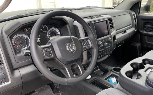

Leather wheel with audio controls retrofitted in my '21 Tradesman. The wheel is off a '15 truck, so I had to move the wiring harness from my '21 into it for it to work correctly. I did not mod it for heat, tho. Took me a couple hours total to do the swap (since I had to pull and install twice due to the wiring harness issue).
