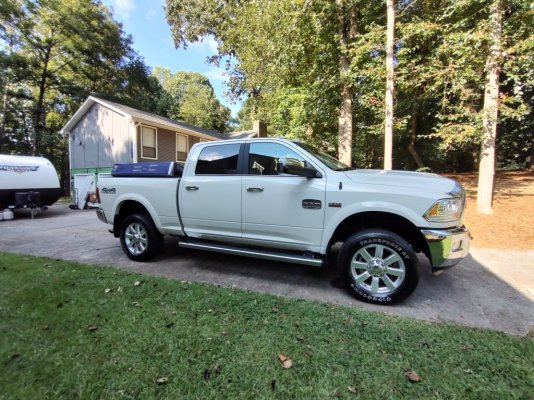

I finally moved to a 2500 and have used it to tow my 33.5' TT fully loaded to Petit Le Mans at Road Atlanta this past month. The difference was night and day from the 1500.
It is a 2018 6.4 with the 6 spd and 3.73. Power was never a problem and it cruises comfortably at 68-70 mph and I see mpg about 1-2 better than the 1500 with the same load. And the best part is ZERO sway now.
Awesome! Beautiful looking truck too. Glad you are happy with the towing performance and end result.
As said in this thread, the 8 speed in the newer HDs and the 4.10 gear is preferable, but the older 6speed\3.73 combo is pretty good too. Best of luck with the new truck!
