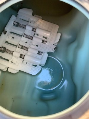

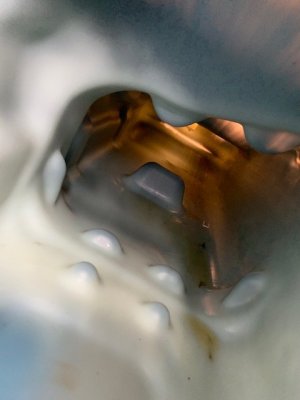

For those with the 32 gallon tank or those curious, there are a couple pics attached of the baffle. Not much really but it does work. Spring loaded divice that places pressure on the walls of the tank to keep it in place. This one was knocked lose during transport but I was able to get it fitted back into position squeezing it back down and sliding it into place. No picture of the baffle installed nor along the way as I had fuel and crap on my hands and continued with the install before cleaning up.
