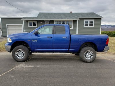

Everything is included and installation is fairly easy. If your truck came with tow hooks from the factory you'll have to remove them for the body lift. I bought the non tow hook inserts for the front bumper to fill in the holes. I have billsteins on the front set at 2.1 with 295/65/20's on 20x9 +1 offset wheels and the dual exhaust tips can be loosened and rotated up a bit to align with the new bumper height.
I used the "gap guards" for the front end and nothing in the rear. The inner fender wells still cover enough after the body lift. I don't recall having to remove the fender skirts. I just added the "gap guards" to the bottom of the front inner fender liners.Are the frame guards needed if i have the fender liners with this 3" kit
Are those 35s? I have a motofab 3" up front and a 2" in the rear. I want more but like others dont want to spend 2k on a lift lol
