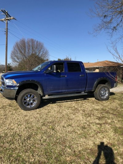

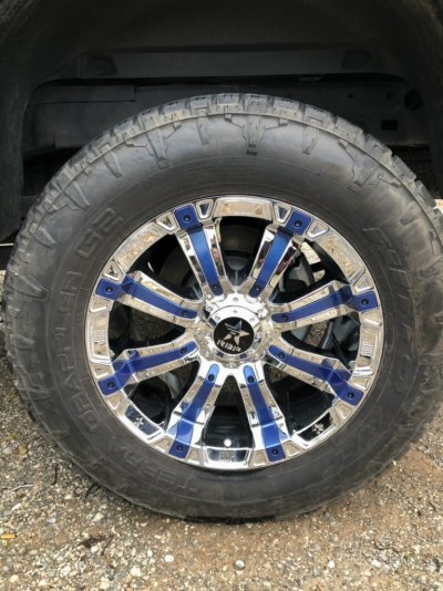

I’m running a -18 offset the factory chrome clad tradesman wheels are +18 offset. The difference is about an inch. Mine rubbed slightly before I put the 2.75 leveling kit on.
The rubbing will also depend a lot in tire design too.
I have Nitto Terra Grappler G2’s 35-12.5/20x10
Although rim diameter doesn’t matter just the width.
My next set of shoes will be 37-12.5/20 brand unknown at this time but definitely will be in the M/T category.
I love my truck!

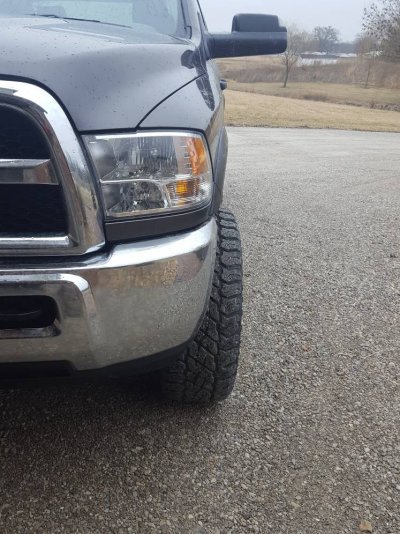

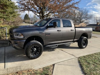

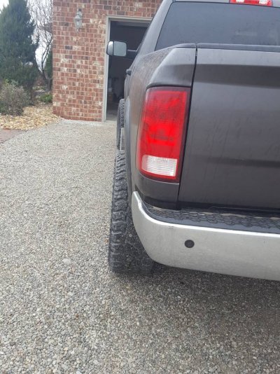

I am running the same thing on a -12 no rubbing whatsoever. I only have a 2in level kit.5a42130e6ddcf3b3338570ad599c55c2.jpg783d8aeafc6ccc7f0d176260577df698.jpg
Sent from my SM-G920V using Tapatalk
Nice truck!
I do rub in reverse at full stop 3” lift 35x12.5 on 18x9 -12
