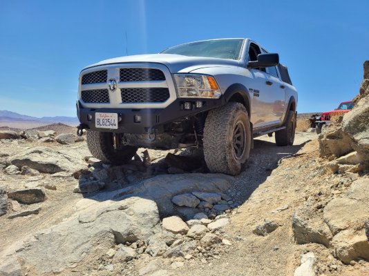

I have the 6 speed auto trans with 3.92's and ran/offroaded KO2 37x12.5x17 for 12k miles with just a 2.5-2.75" lift before i went back to 315/70/17. MPG sucked badly in the city which i new it was bound to happen, acceleration wasn't bad but i lost the peppines on the truck and i was using the tow switch a lot going uphill, but for me the most important thing was the offroad performance was compromised as 4hi in the sand sucked as the truck felt extra heavy, and i mean she's about 800lbs heavier than stock with all the mods i have but still ... she doesn't feel that way running 315/70/17's. All in all my bottom line was affected (offroad) so i sold them and went back to 315/70/17's. I can say in general 3.92's even with a Hemi wouldn't be the right gearing for 37's, let alone one with the 6 speed trans. It shoud be better with the 8 speed but only you can make that determination.
I loved my stuffed truck on 37's
48755971012_10225ce87b_h.jpgUntitled by RAM RSM, on Flickr
48888437151_1469f896fc_h.jpgUntitled by RAM RSM, on Flickr
48390015177_0d82170167_h.jpgUntitled by RAM RSM, on Flickr
But she's a lot more agile on 35's
51396451528_83686e0c56_h.jpg20210822_144824 by RAM RSM, on Flickr
51140138420_4ce0224280_h.jpg2021-04-25_08-42-19 by RAM RSM, on Flickr
51137694025_0b4b94c94e_h.jpg2021-04-24_08-28-34 by RAM RSM, on Flickr
51108116111_52112851fc_h.jpg2021-04-10_04-59-28 by RAM RSM, on Flickr
Good luck.

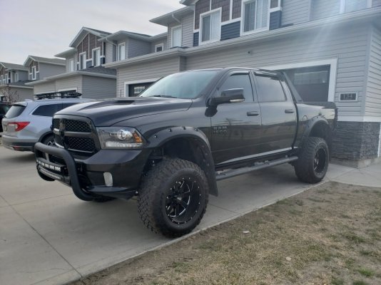

Love the 37's !! Especially on a big ol nasty 20x12 wheel! With 9" of total lift. 6" suspension and 3" body. I'm in Canada so highway speed is 100km or on a divided 4 lane 110km. Truck drives fine for me. Like my ramforum name im in a 8sp with 3.92 and have no reason to regear, but im happy how everything is. If you don't go with what you really want, you'll regret it...no regerts!! Best of luck.
Let us know with what you decide.
Cheers

I like the front bump, can I ask where you got it and how much did it cost?

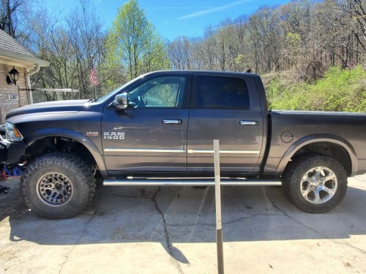

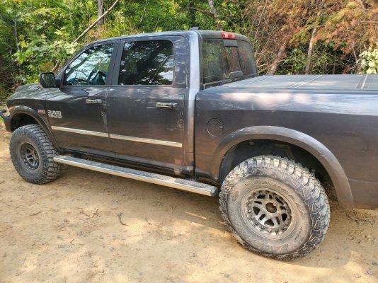

6/3 BDS kit,w/ Fox coilovers, I started with a 295/65/20 on stock wheels. Now 37/12.5 on 17" Hutchinson wheels. I love the 37's, great ride. I have some extra weight on the front and back. I have 3.92's, truck still drives well with the 8spd. I would love to have some 5.13's. Last pick for comparison of tire/wheel combo.

I like the 37's but I don't DD it. I do wish I had more gear than the stock 3.92 but they work, especiallywith the 8spd. I manage to get out in the woods every once in a while and the truck does well, (definitelybigger than a Jeep). I did upgrade to a set of Hawk pads front and rear and that helped alot with the brake. It wasn't that bad with the stock pads but my wheel/tire combo isn't light.
