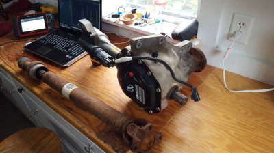

Got some new used parts today from ebay, very exciting. Now just need some brackets. Hopefully I can use a lot of it, but if not, that housing is $1200. I think I scored for $280 something.

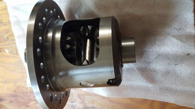

After much to do, Machined LSD is finally in my hands. The biggest shout out to Matt @ Moes performance for his dedication/Labor. Without him, we wouldn't be "Fast Ram Trucks". Josh @ Modern Performance Engineering, invaluable product for this mod. Just saying!!!!!!!!!!!! thank you!
