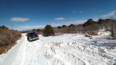

Driving in heavy mud while going up some steep grades just out of Gateway, Colorado on the dirt road to Moab, Utah some 6 weeks ago I needed to have both the front and rear lockers engaged while running tire chains.
Per Mopar...
"To lock the rear axle, place the vehicle in 4LO. Refer to “Four Wheel Drive Operation” in “Starting And Operating” for further information. Move the axle locker switch position to REAR LOCK while traveling less than 3 mph (5 km/h)."
At some slippery mud sections of the Gateway to Moab road with its corners and steep drop offs (cliffs) I let the truck crawl along at 3 to 5 MPH to keep from sliding. However, there were some flat straight road sections with some 18" of deep snow of which I hit around 40 MPH to be the first vehicle to plow through it. Needed the higher speed momentum. Never made it through though due to the road at the higher elevations became too heavily snowbound. Photo below of tire tracks in the snow are all mine. Couldn't go any further. Backed up for about mile or more and turned around.
Took it out of 4 Low and put it in 4 High while nearing Gateway, and sure enough those lockers disengaged even with the switch still on.

I had a feeling that If there was an application to go that fast in 4L it would be snow. So, if south AL ever gets a blizzard, I’ll have the truck for it!! We can get a dusting down here and it locks the State up tighter than a virus. You need the Abel locker bypass.

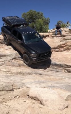

Edit: going downhill while rock crawling, it's almost impossible to stop that truck.
Like standing both foots on the brake.
