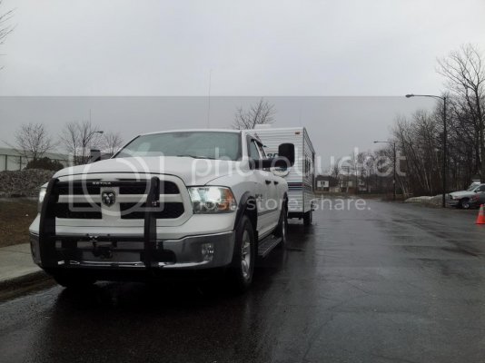

Thank you ! :)
I had a 1 hour highway and a 20 km urban trip from where I bought it to my house.
It was a rainy day with some hard Wind. The first thing I noticed was the ( don't know how to say this in English ) the trailer was push hard by the winds. Nothing extrem, but my hilo trailer was far better for this even without any tow bar and sway bar. But I can't complained, that not to bad for something that size.
The 5.7 and the 3.92 pulled this trailer easily compared to my sierra 4.8 with the 3.08.
Also the braking seems better.
I don't know how the used travel trailer market is in the us, but for here I got a huge deal on this trailer. 3500 $ with the bar kit and like I said the trailer is like a brand new.
