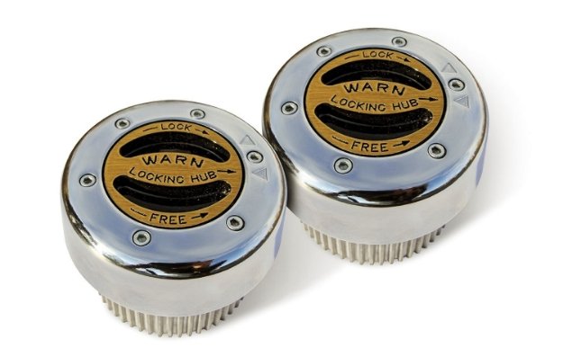

I don't know what you have at the wheel, this is how hubs are locked, if you cant do anything nothing to turn, then it is auto locked when you engage any 4x4 mode, of note if it is auto hub, when you go back to 2wd you should reverse until you hear a click that is auto hub dis-engaging. If it is manual, it is self explanatory, if the hubs are locked and hard to spin, try a little reverse here and there.

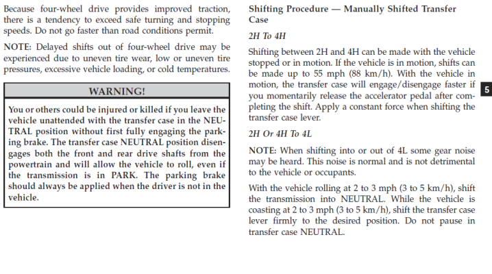

If you don’t have manual locking hubs, you can shift into 4H at speeds up to 50 mph. Same with going back to 2Wd. You need to be stopped put truck in neutral to shift into 4L . Same to shift out 4L.

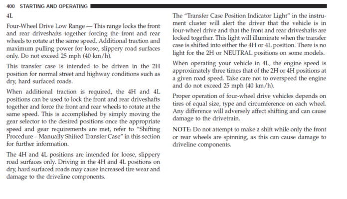

A Ram truck hasn't come from the factory with locking hubs since maybe the early 1990's, so surprised anybody is even mentioning them. There are retrofit kits out there for manual locking hubs but they are very pricey ($2,500ish) and very rare anybody has instlalled them. Speaking locking hubs on older trucks, you still had some sort of shift lever in the cab that went from 2wd to 4wd. I've never seen one where ALL you had to do was engage the locking hubs (I learned how to drive on a '72 model Toyota with locking hubs, and have owned several trucks with locking hubs back in the day).

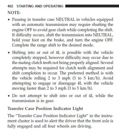

Back to the original post. You simply move the lever to the position you want. There should be distinct detents as you move the shifter. If you are in 2HI and want 4HI, just reach down and pull the shifter back to the 4Hi position. This can be done "on the fly". I've done it lots of times at probably up to 40+ mph. Just let off the gas for a second while moving the shifter back. The only reason I haven't done it at faster speeds......usually if the you need 4wd you probably aren't going that fast. Now if you want to go to 4low you do need to stop as this drastically changes the overall gear ratio. If the shifter fights you going into 4low get let off the brake or maybe a real small/slight bump on the gas pedal to let the truck roll. If you try to shift into 4 low while traveling at high speeds the shifter will usually really fight you when you try to move it.
