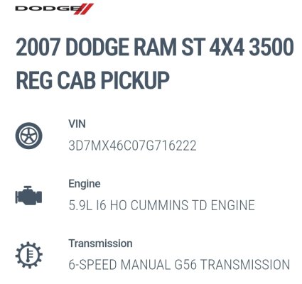

Lady friend has dodge 07 3500 dually , engine # 57583020 can’t find if 5.9 or 6.7, just doing regular maintenance.
Thanks

that vin doesnt appear right?
But 6.7 was introduced midway through 2007. Best bet would be look at the data plate on the side of the block near the fuel pump
also in the vin, i believe the 8th position will be c for 5.9 and a for 6.7
C = 5.9L I6 CYL Turbo Diesel High Output (ETH)
A = 6.7L I6 CYL Cummins Turbo Diesel (ETJ)

A quick search says that 53040317AM is the ECM part number for a 5.9L Cummins, but you may want to verify.
mtnrider
Sep 25, 2014
3,538
4,298
Georgia
Those valve lash specs on that label are for a 6.7, but I'd still look for some other way to verify.
5.9 is .010/.020
6.7 is .010/.026

Any chance you can get the VIN of the truck itself?
06 Dodge
Jan 4, 2022
2,780
3,311
Forest Grove, Oregon
6.7L CTD
Thanks
IIRC Jan 2007 is when the changed over from 5.9 to 6.7, I recall hearing of a few Jan 2007 trucks with the 5.9, they used up the 5.9 they had on hand before going to the new 6.7, also if it has a factory EB its a 6.7

OP, if you post the VIN we can put this to bed quickly.....
or at the very least take a pic of the engine bay.... Should be fairly easy to determine at least by that. The 5.9 and the 6.7 aren't identical and a 6.7 should say 6.7 on the valve cover.
I didn’t see 6.7 on valve cover, I’ll get vin#
