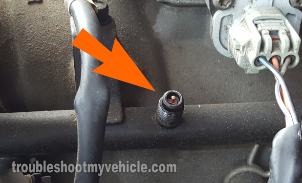

Check your fuel pressure, you should have 47-51 PSI (Key On Engine Off).

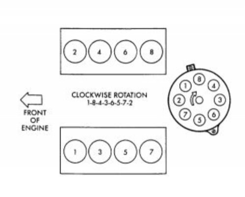

Since the original problem was no spark, most likely the cap and rotor is what fixed it. Since you changed everything, double verify your firing order. This diagram is for your truck, 2003 5.9. Sometimes people get confused which cylinder is what.
If it persists after that, your left with timing, air and compression.
