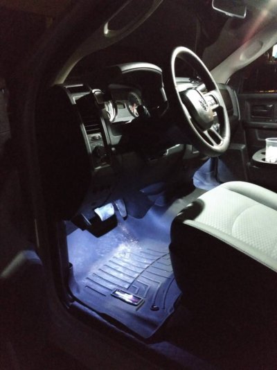

Any wiring tips?

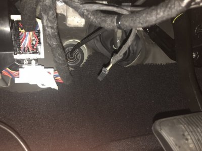

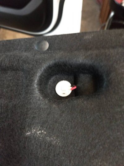

The wiring is already there on both sides. I cut the factory plug off and put some connectors on there. Took about 15 mins per side.b62278f4b2281b306c783ea53332132a.jpg

wait... where exactly is this mounting location with the wiring??????

Thanks for that video. I installed the same lights this morning. The bulbs were $13.99 @ Canadian Tire. I managed to score the sockets at the wreckers this morning off a older Gran Cherokee. Cost me $1.23. I almost **** myself. Dealership wanted $20 each.

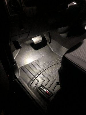

i did mine just after i got the truck.there the same led lights as i got in my grill.also have to do the back seat lighting
Sent from my Moto Z2 Play using Tapatalk
When do they turn off with that wiring location? Do they stay on along with the other interior lights?
That wiring is for the factory footwell lights so yes, it works off the same power as the rest of the interior lights. More expensive packages come with the lighting installed.
Awesome, thanks!
