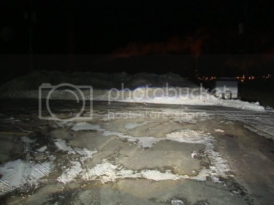

yeas i did. look sweet but i need to do some major adjusting. body line along with light adjustment.

why does the light cut off like that on the left. when i made sure the adjustment tabs were the same before putting the fog light in..... :mad:
So the second one is the fog cutoff?
Btw, it looks good

first it lows+fogs, second is just fogs
Cant recall if mine does that....but there is no way to really adjust the fogs as we do with the heads....but maybe Jeremy can chime in here

From what i see in the pic too, you need to raise the drivers side fog up a few.....just look at the arches in the bottom of that pic. They dont line up or are not the same height.

fogs you adjust with the white dial on the bottom of them. :D
