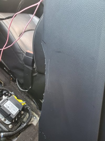

Works...
Had to take out vent pipe underneath console
Had to trim bottom on both sides for hump on floor
Used a switched 12v and ground wire to splice in the usb ports.
Not bolted in yet.
But I'm happy so far
Need those side pieces like 3rd pic has in his.
View attachment 480820View attachment 480821View attachment 480822

Got it to fit with some mild cutting of the front section it bolted right up. IMG_2655.jpeg

Works...
Not bolted in yet.
5th gen center console with the side pieces out of a 4th below the radio bezel? That looks very good.
