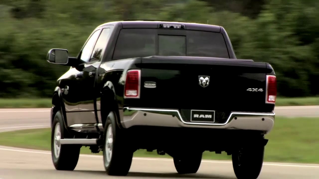

Alot of people use the Alt Height feature for towing.
Ram mentioned it used for Trailer towing in the feature video below.
Goto 1:22 time mark for 2500/3500 explanation.

Thanks for the video. Not 100% sure it means it works when towing though.

Do a Google search. Plenty of responses in RV and other RAM forums of owners doing exactly what you want to do and is why Ram called it Alternative Height .
