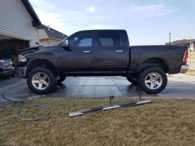

Welcome! MOPAR sells renamed 4" superlift kit, that if installed by dealer, supposedly won't void warranty. A 6" superlift installed by a shop will not be the same. There's kind of a grey area and difference in what people will tell you about a lift voiding a warranty. Lots of threads on here regarding that subject. You can run your factory wheels with the lift, but they will require spacers to clear the knuckles. Get a good quality hubcentric spacer and you'll be fine. Most go with 1.5" from B.O.R.A. Here's a pic of my set up on factory wheels for reference, 6" lift

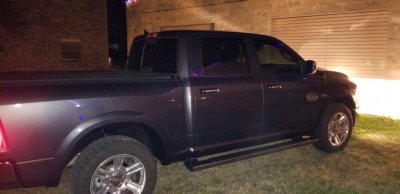

My dealer installed 4" Mopar Superlift with 35s. Was told by 2 dealers that even if it's dealer installed the warranty is only good for 2 years.1555.jpeg 0504171311.jpg
