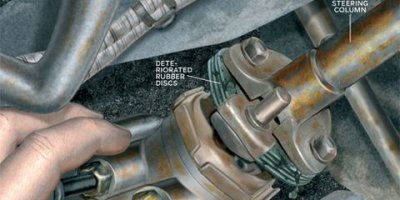

    I've recently rebuilt my steering columns in 2 of my trucks. There should be a 'non removable' circlip below the bearing and one above. you're missing the one above. the steering housing bolts to the fire wall and will be tough to push back down since the resistance of the bearing on the shaft will likely push it along not revealing the groove for the top c clip, as there is give on the rag joint. that's why you'll probably need to unhook the rag joint or u-joint depending on which ever your year of d250 has and push it towards the steering wheel direction. You might need a second set of hands to hold this pressure as you push back on the housing and the groove should become visible. only other easier way is to remove the whole assembly and use the floor as counter pressure. that's what I did. but that's a lot more work for you.
    Ujoint or rag joint joins your steering shaft to the steering gear/box.
    You probably have the first type of connection.
