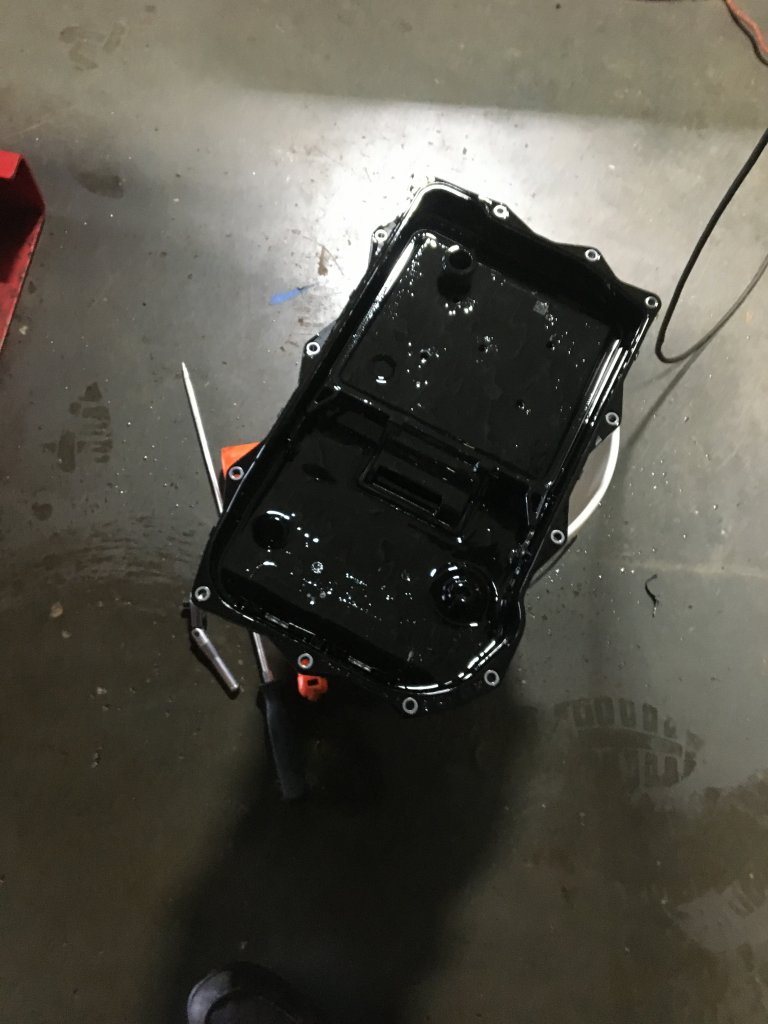

12 k used a OE pan the magnets and filter looked good but I wanted it over before redynotuning it after i get them to do the trans tune that screwed up the Procharger tune somewhat.It looks dry.E3EFDD40-F4B3-4B21-A4C2-A12FBDD43BE1.jpegimage.jpg

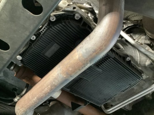

As promised, here's a picture of the amount of clearance I have, shown with a 1/4 in. Ratchet head in between. I did get the fill plug broke lose by using the jack bar as a breaker bar and a cut down 8mm allen wrench. I should be good to go now. The trick will be no burns. I'll probably start later this afternoon after it cools a bit or wait until tomorrow.

All done with the fluid swap and no burns. It took 3 quarts before startup and a total of 5.75 quarts with the dorman pan. Probably lost half a quart or so at the end when it started spewing out. I plugged it back up a little before it was a slow dribble because I wasn't able to get completely even left to right, but was even front to back.
Fluid was brown and definitely needed to be changed. 93k miles and no towing, but I do have 37's and a tyranny tune. I'll probably do another fluid swap in the not so distant future since it was not a full flush. The magnets were coated with metal and there was a decent amount in the pan as well.
